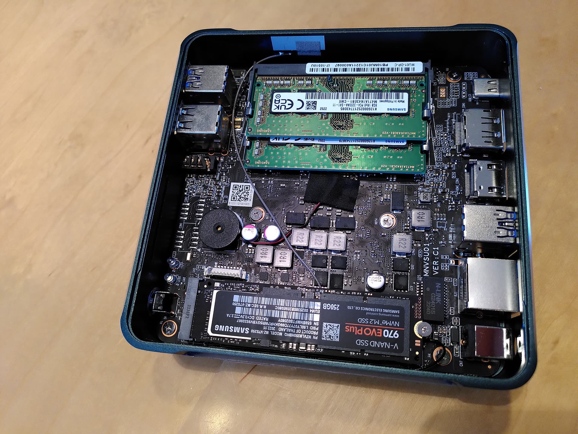

I don’t see any problem here, any hints?
@howil Thanks for the photos - I don’t see anything obvious on the visible side of the board, like a tombstoned component / short / etc., but high speed issues can be much more subtle.
(I also replied here related to this issue: Librem Mini v1/v2: Feedback request for USB tuning preview build - #6 by jonathon.hall)
