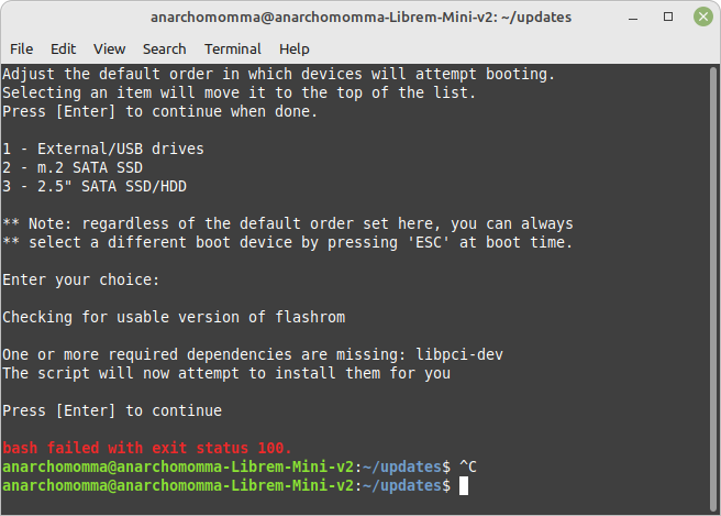

Hello, I’m trying to do a fresh install on Linux Mint on my Librem Mini V2. I cannot get the system to recognize the USB drive. I have tried multiple drives multiple times. I found the USB Tuning update and attempted to install that to set the USB drives to the first in line for booting but that errors out. I’m attaching the error here. Please advise how to get the system to recognize the USB. Thanks.

Given that it says “one or more required dependencies are missing”, it may help to attempt to install that dependency manually. If it works, try the procedure again. If it doesn’t work, you might at least get a better error message.

sudo dpkg-query --list | grep libpci-dev
Is anything listed?
If so then post the output here and then STOP.
If nothing is listed then the package is not installed, in which case:
apt search libpci-dev
If nothing is listed then you may be out of luck. Note that fact here and STOP.
Otherwise:
sudo apt install libpci-dev
If you get an error then post the output here and STOP.
You don’t so much need to worry about finding the file. It is either in the repository/repositories that you have configured, or it isn’t, and if it is then the system will find it for you.
irvinewade that worked. I was able to install the libpci-dev. Thank you.
