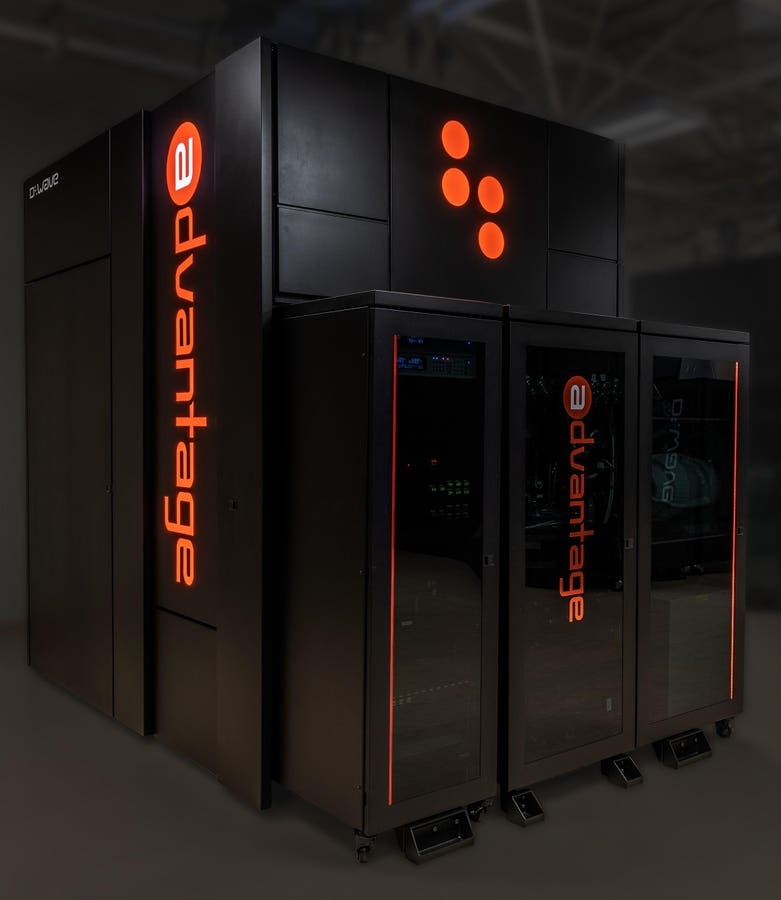

http://cjc.ict.ac.cn/online/onlinepaper/wc-202458160402.pdf
From: https://thequantuminsider.com/2024/10/11/chinese-scientists-report-using-quantum-computer-to-hack-military-grade-encryption/
Except it’s a 22 bit key of a subset of the encryption algorith. So it’s both an unrealistically small key AND not the full algorithm.

@Randy, @Randy, Please. Have you even read the abstract of that paper? 50 bits is nowhere near military grade. Improve yourself!

Yes, you’re right, I’ve raised this internally suggesting to reword it to ā€œa reduced form of military-grade encryptionā€ or something to that effect.
I saw that sources describe it this way (including the one linked above). The abstract does say they factored 50 bit integers, and that news article suggests that there are limitations preventing it from applying to full size keys (e.g. not just money or scale).
Obviously as others have said, it’s on the brink though :scream:
