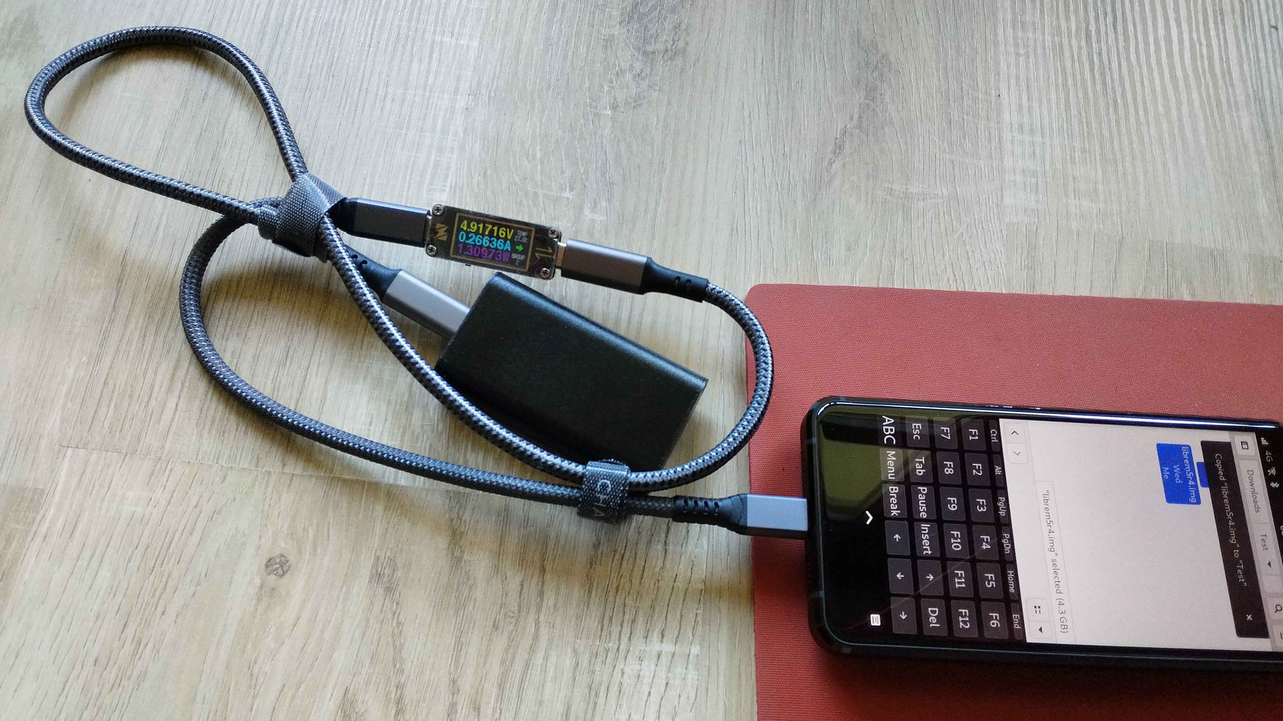

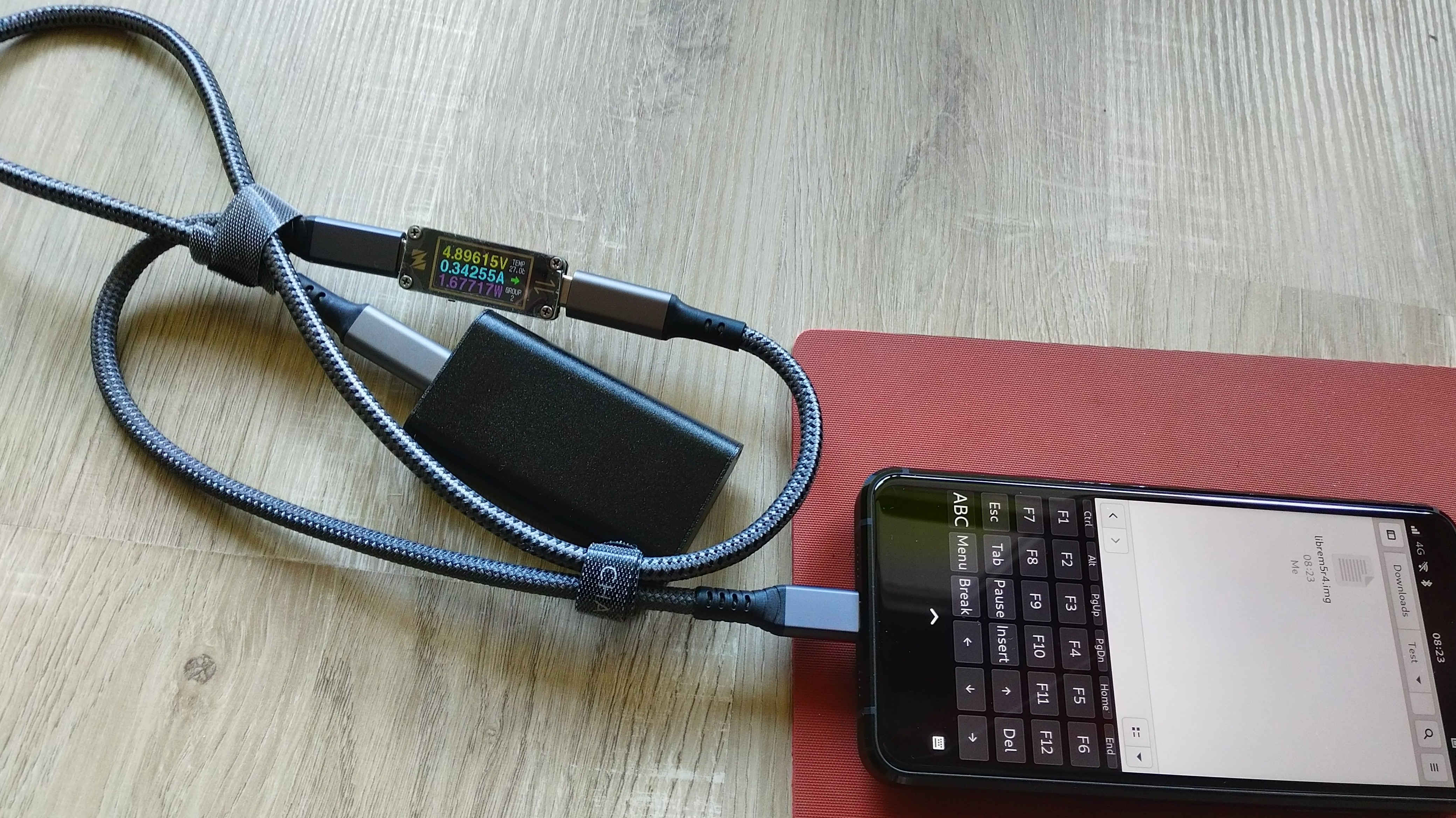

As long as you are not using Librem 5 as a power bank* … or rather I’ll do that here showing two picture of currents of 5V/0.26A (standby mode, as mounted) and 5V/0.34A coming out from Librem 5 USB-C port in direction (please follow green arrow shown on measuring device) or toward some low consumption (just let me present it as such here) 256GB external SSD drive (just not to write here things that might not be simple, although logical, to explain):

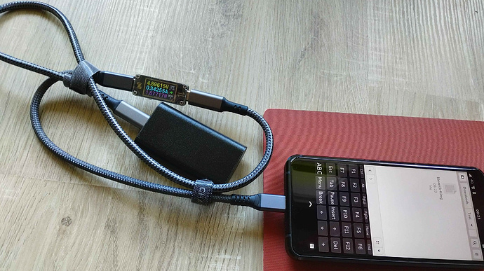

*I have one in mind, it is old school 5V only based, with four 18650 cells (still have them somewhere), but not sure at this point if I’ll be able to get another one next week for the purpose of another (actual) discharging test (in order to measure max. 5.0V current going out from the Librem 5 USB-C port toward 5V microUSB from power bank that is built-in as its charging port only, to this very old school Anker power bank: https://powerbanktest.net/test/anker-powercore-10000mah-quick-charge-3-0/ by expecting to pull out 5.0V/1.0A from Librem 5 USB-C port at least, for short time only). But anyway and what I might already conclude by myself, unofficially of course, USB-C port of Librem 5 should not be brought into situation where current passing through exceeds 1.5A, whatever direction used, in or out … even if from manufacturer provided/maximum Continuous Discharge Current/rate of BPP-L503 battery might be rated at more than 3.0A.
EDIT: Actually and to be correct, Librem 5 passing through the USB-C port amperage (besides throughout clearly defined precise voltage value) when charging only its battery should not to exceed much more than 2.0A (approximately and in total with its screen on) as necessarily and kindly presented here:
