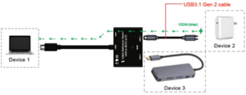

@ChriChri, perhaps following setup might help you (where Device 3 would be your Nexdock360):
Screenshot_from_2022-04-30
Rest of this idea is, sort of, explained here: New Setup for 3 Computers Hardware.
Do I understand you right:
  • Device 1 = Librem 5
  • Device 3 = Nexdock360
  • Device 2 = very powerful charger
Video/usb-data gets routed through the “magic device” between Device 1(L5) and Device 3(N360) and both devices draw power from Device 2(very powerful charger).
The “magic device” in the middle talks to “very powerful charger” using PD to get the power specs and tell the charger what it needs and each of the devices N360 and L5 talk to the “magic device” to tell it how they’d like to be provided their power.
Did you try this and is is known to work?
I looked for such a device (I searched for something like “usb-c power injector pd”) and didn’t find anything.

That would be original Librem 5 power supply.
No just Librem 5 would draw power from the connected power supply (although I’m not familiar with N360 at this moment).
Sorry but no. I do not possess N360, but still it would be nice that you try this (for the rest of us to be aware if indeed helped), just thought of mine that this “magic device” might be the one that you need in between this combo (and solve this Librem 5 charging issue).
I’ll try and let you know. Found the “magic device” at a reagional dealer so that’ll be easy to return it if it doesn’t work like expected.
Is it not just a powered USB C hub?
If so it wouldn’t work as expected. It needs to pass through the hdmi signal, also. Furthermore it’d need - as I understood the PD protocol - to intercept the data traffic to deliver meaningful PD information to all connected devices.
Maybe someone with more inside in PD can fill in some knowledge here and correct my simple or even wrong description?
Setup, as I understand above screenshot, for related “magic device” (Device 3 = Nexdock360) should be the very same as shown here (there exist only one USB-C port on N360 that supports DisplaPort, yet please correct me if I’m wrong):
Second option for the same Device 3 = Nexdock360 would be USB-C to HDMI Adapter (for example: www.aliexpress.com/item/1005002012736689.html), actually both related ports that you plan to be used with this “magic device” are placed on the left N360 side.
And, as hopefully clear from the screenshot above, only device that would get powered from is Librem 5, getting power from its original power supply as 5V/3A. Charging USB-C port for Nexdock360 is on the right side of this device and I have no clue which voltage/power it consumes, as those numbers probably quite irrelevant here, IMO.
