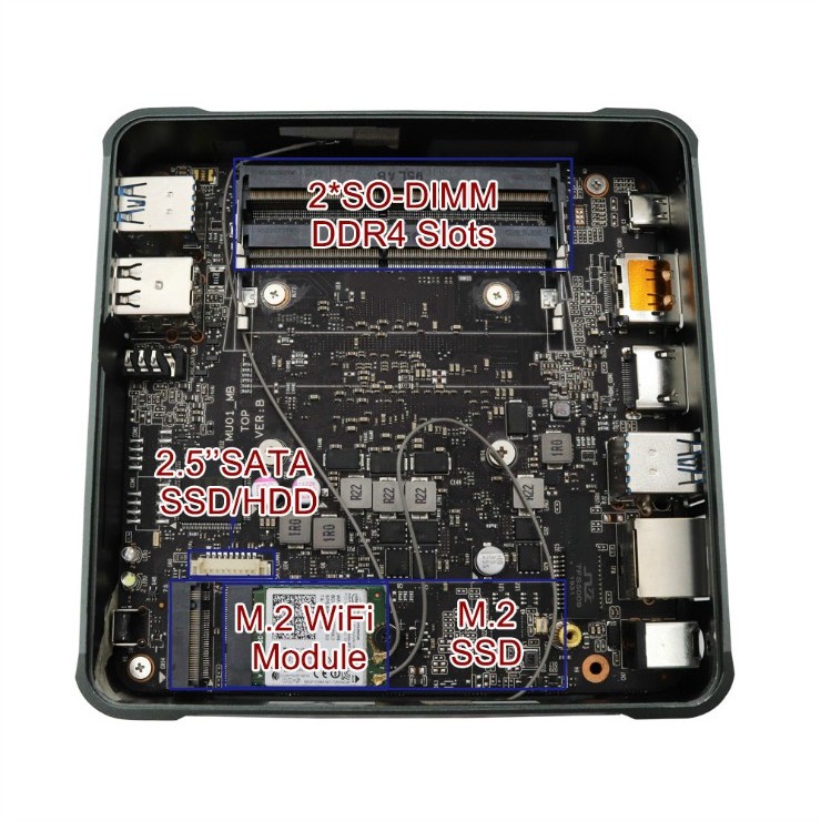

Hi all . I wanted to order a Librem Mini for myself. I started studying information on how to flash my Mini Coreboot after purchasing Purism Librem Mini (v1, v2) — coreboot 24.08-285-gb95c498635 documentation
And I discovered that the internal contents, that is, the motherboard is the same as that of NitroPC 1 https://shop.nitrokey.com/shop/nitropc-1-132?search=nitropc#attr=225,229,239,237,244,245,247
as well as Barebone Whiskey Lake U https://techtablets.com/2020/05/299-barebone-whiskey-lake-u-core-i7-8565u-mini-pc-review/
or NVISEN Y-MU01 NVISEN Y-MU01 (i7-10510U) Testbericht are the same, that is, they are the same Chinese manufacturer. Correct me if I’m wrong, it would be better if there are links or comparison tables.
That is, it turns out that this is the same device in terms of hardware, but the price may differ by half, for example NitroPC 670 euros and Purism Librem Mini 700 $ versus 300 $
I would appreciate your opinion and information.
The Purism Librem Mini is based on the NitroPC 1, similar to the Purism Librem Key being based on the Nitrokey Pro 2. Looking closely at the NVISEN Y-MU01, it does seem to bear a strong resemblance, although I am not certain if flashing Coreboot or PureBoot (Basic) will work.
@jonathon.hall
The Librem Mini (version 1) was, IIRC, a rebranded version of a $300 eglobal generic NUC https://www.eglobaltech.cn/ViewDetails270.aspx . I believe I confirmed that by doing a reverse image search on some of the motherboard pics in Purism’s FCCID filing ( https://fcc.report/FCC-ID/2AT9R-LMV1-01/ ) .
I don’t think Purism has an FCC filing for the Mini V2. I assumed that the Librem Mini (version 2) was also a rebranded Intel Core i7-10510U eglobal NUC-like-device. Here’s one that looks almost identical Product Not Available
Hello . Thanks for the answer . If you look closely, this is the same motherboard MUO1_MB, it is installed on Librem Mini on NitroPC 1 on NVISEN Y-MU01.
As for the software, you can use PureBoot or you can use Coreboot, I think this is a separate topic, what is the difference and what is more free from the point of view of blobs…
Hello . Yes, you’re right, version with Intel Core i7-10510U processor (Intel Management Engine (CSME 14.x) (v2)

Librem Mini wasn’t based on NitroPC 1 (nor was Mini v2 based on NitroPC v2, etc.), as far as I know. While they share board designs, as far as I can tell the Minis came first, and the respective NitroPCs ship Mini firmware modified with Nitrokey’s configuration. (See e.g. the NitroPC firmware builder, the NitroPC v2 configuration is CONFIG_BOARD_PURISM_LIBREM_MINI_V2 with the vendor name set to Nitrokey, etc.: coreboot-builder/nitropc-defconfig at main · Nitrokey/coreboot-builder · GitHub)
I can’t say for sure whether it will work. Designs like this often have many options and can be populated in different ways. Some of the obvious ones you can see in the photo are the optional COM port headers, the option for a second Ethernet interface instead of the rear USB 2.0 ports - but those are just the obvious things. The design may support alternative parts for any number of internal components that wouldn’t impact end-user functionality, but allow the vendor to adapt to fluctuating component availability. The EC firmware may change, possibly requiring corresponding changes in the system firmware. If so, it should come with matching vendor firmware, but work in coreboot might be needed to interact with the EC in the right way.
When we ship devices, we ensure that everything works, either by ensuring they have the same components where it matters or by adding the necessary support to coreboot for the variations that we have shipped. For example, Librem 14 recently gained support for new Comet Lake steppings, and Librem 11 added a second set of HDA verbs for an alternate audio codec.
So I can’t know for sure whether a device from another vendor will work with our firmware. You’re always welcome to try it, and contributions upstream to coreboot to support more variations are appreciated.

If I knew for sure that the motherboard for Librem Mini, NitroPC1, NVISEN Y-MU01 is from the same manufacturer, then I could experiment)) But as you correctly noted, for example, the Purism company could buy these boards and then adapt them for certain software and this could differ from the same NitroPC1 board.
I’ll try to read more and study who the manufacturer of these boards is.

Actually my point is that ODMs like this often vary components in the devices both for configuration options and component availability, like I discussed above. So even if they are from the same manufacturer, there isn’t a firm guarantee whether firmware from Purism or Nitrokey will work, work partially, or not boot at all.
You will have to estimate the likelihood that the firmware will work acceptably (depending on what is acceptable to you) and weigh that against the difference in cost :slightly_smiling_face:
I can’t really characterize that likelihood, but I can give examples of things could vary that require changes to firmware, like the Librem 14 and Librem 11 examples above. Hope that helps :slightly_smiling_face:
I agree with your idea, but still, if you know who the manufacturer of the motherboard for Librem Mini (v1, v2) is, I would be grateful for the information.
I would like to buy this board and then flash Pureboot and then Coreboot and compare the performance.
