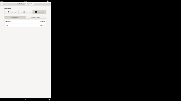

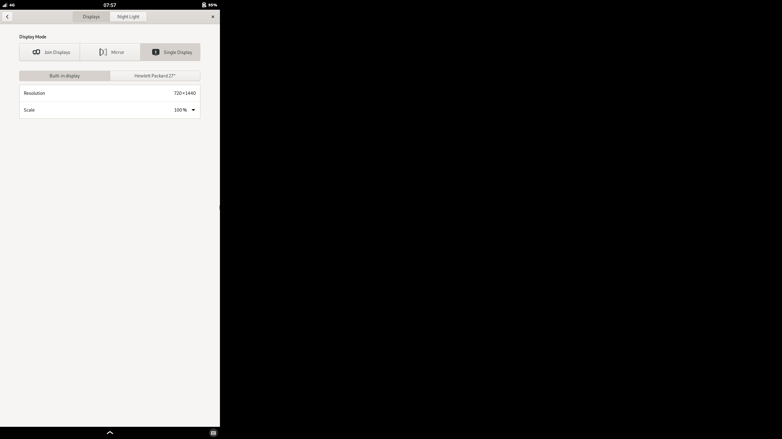

When i connect it between the phone and the hub however the video/screen signal does not get transmitted to my monitor.
(Despite the monitor being recognized in the librem 5 settings)
Without using the extension it works great, though.

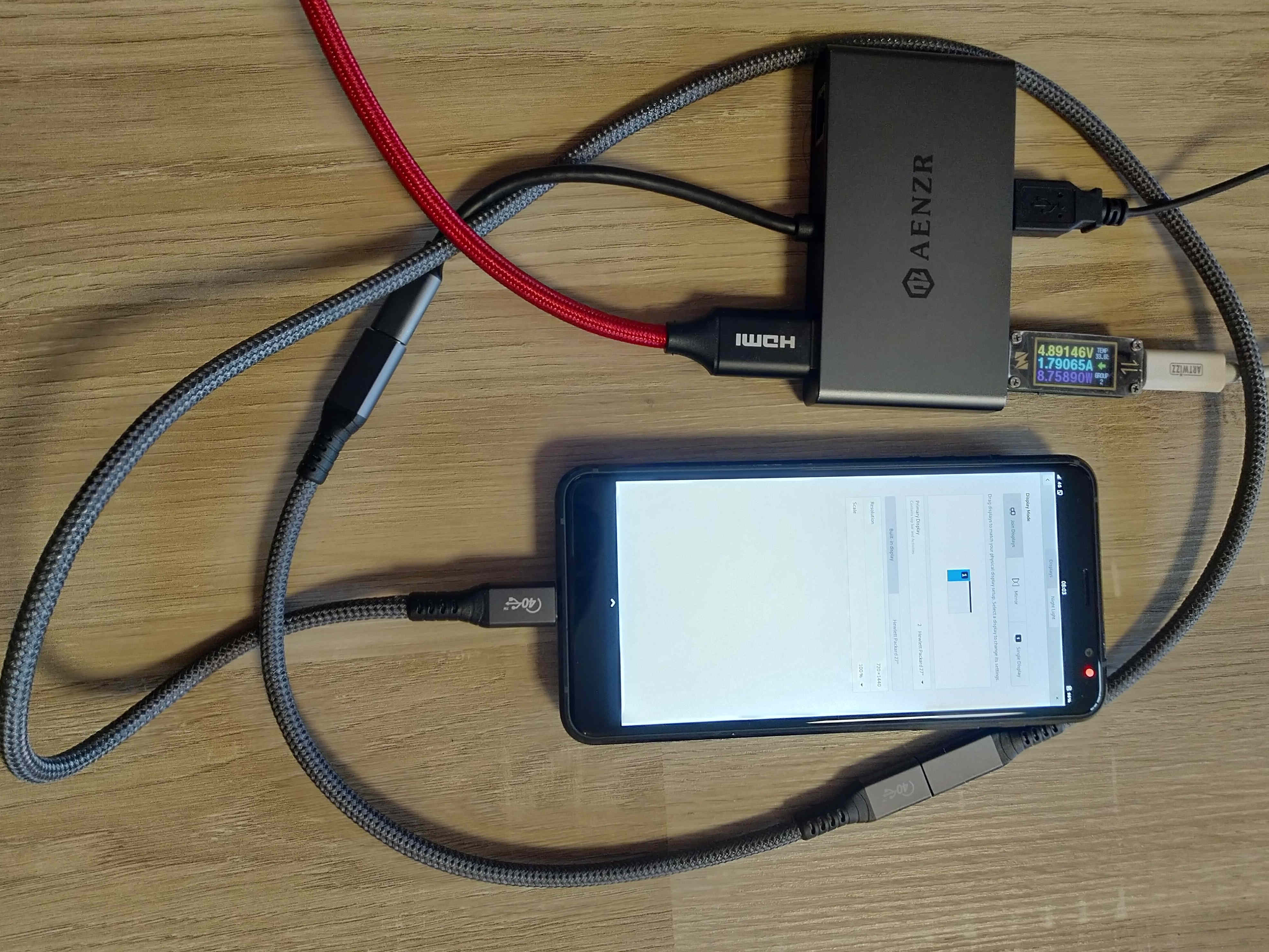

In short, general and exclusively related toward USB4 extension cable (it works, even if used twice :upside_down_face:):
I’m noticing other issues (perhaps software related, the one that is still in development) with my non-… external convergence equipment, but still hope that my answer somewhat helps (as toward your question related).
I’do not know much about at this point of time (but will look around based on …, but shorter data cables we are considering as the ones that are more reliable/quicker (video signal related …).
EDIT: @Michael24, please take a look at this link: HDMI-compatible 2.1 Cables 8K 4K 60Hz MOSHOU male to female Adapter Dynamic HDR ARC CEC High Definition Video Extension cord - AliExpress 44, in order to get there … as quite more reliable solution (another setup idea of mine that includes connection to the above linked HDMI adapter from DELL, before you decide to buy anything new, and going to search for something else as well, yet this HDMI extension cable setup I’m already warmly suggesting, and even manufacturer is the known one or the one that I should recommend here).
EDIT II: Now after another short test I do not think (not any more) and almost sure that using USB4 extension cable is something not to be recommended at all (as possibility of getting the HSYNC and VSYNC blanking intervals on your external screen/monitor is relatively high), therefore please stick toward buying of adequate (in quality/length) HDMI extension cable (as my primary advice, while all my writing up to this point was actually based on your intention to use USB3.2 Gen 2 extension cable or USB4 extension cable with the here related docking station, or any other).
