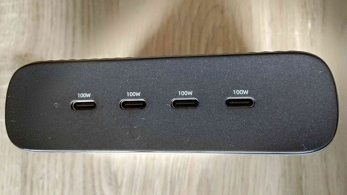

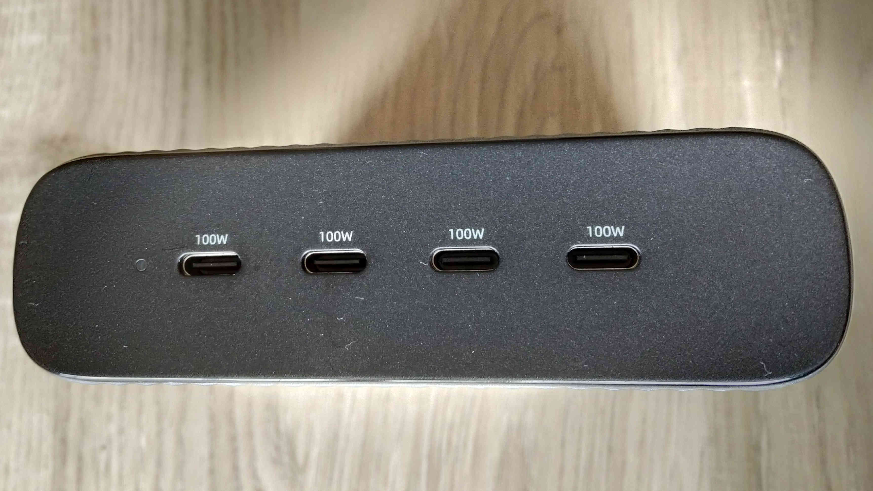

As and when the Librem 5 connected as host, over its USB-C port, to the compliant docking station we need to provide to it up to 15W (5V/3A). If and when negotiated less than 2.5W (as within docking station built-in pass-through charging controller just do not like to “talk” properly with your carefully chosen “most expensive” PD3.0 power supply with up to the 100W per USB-PD port).
Each USB-PD port, as shown below, might be usable
 (but let us focus, please, on what needs to be ensured, for this topic purpose):

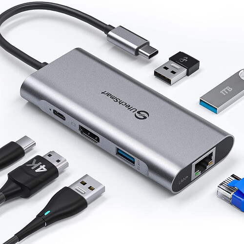

I just bought one.
https://www.amazon.de/gp/product/B07DRGP8QW/
I only found these on banggoods
Where they are out of stock.
Can i get them somewhere else?
Wouldn’t be this one sold by purism the best choice?
or am i missing something?
I would assume so. I had no idea they sold a hub.
Edit: don’t see any display out, though.
It has hdmi. You probably missed that.
Ah so I did, I thought that was another USB in the picture.
I’d just buy that one then.
