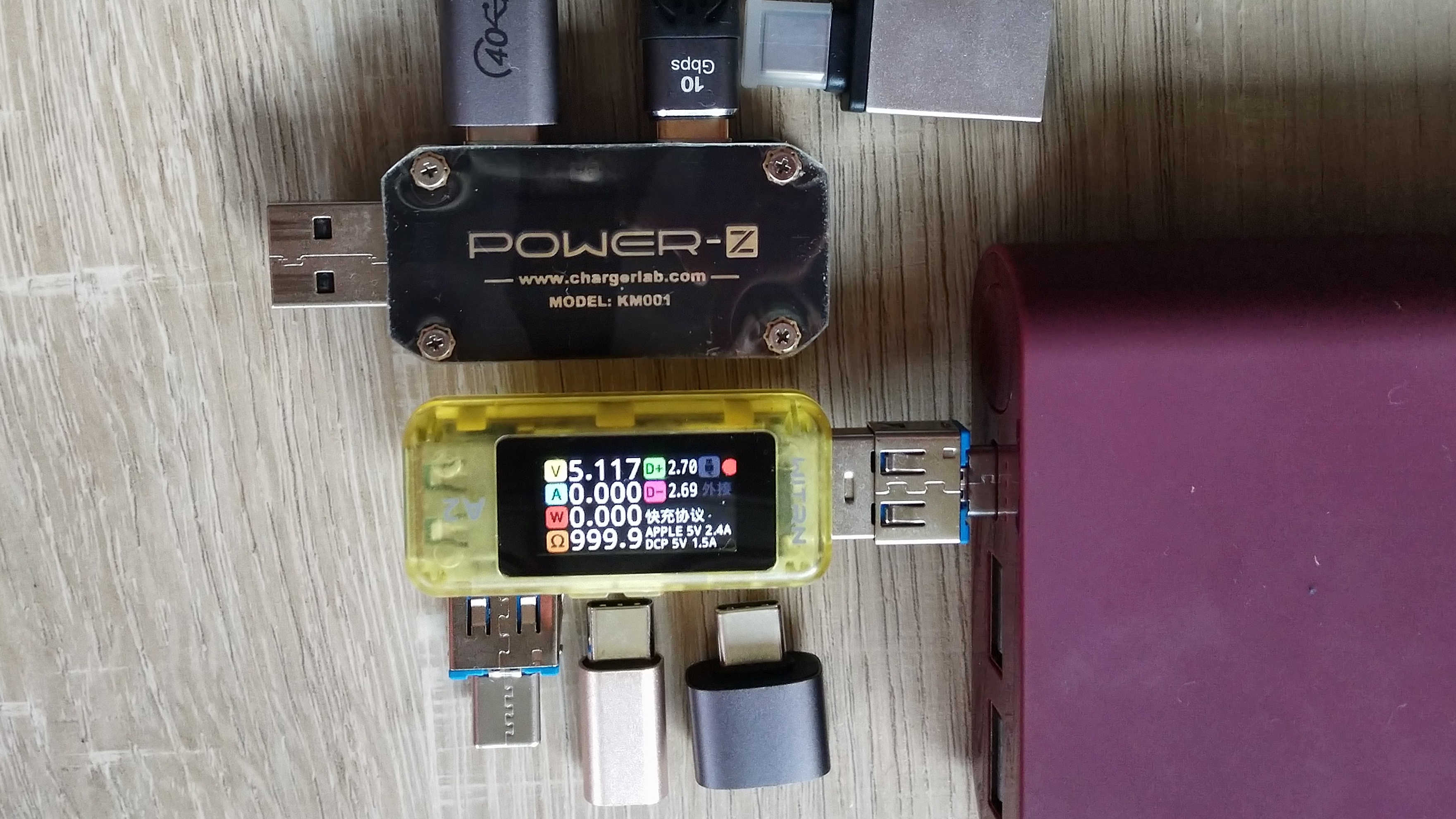

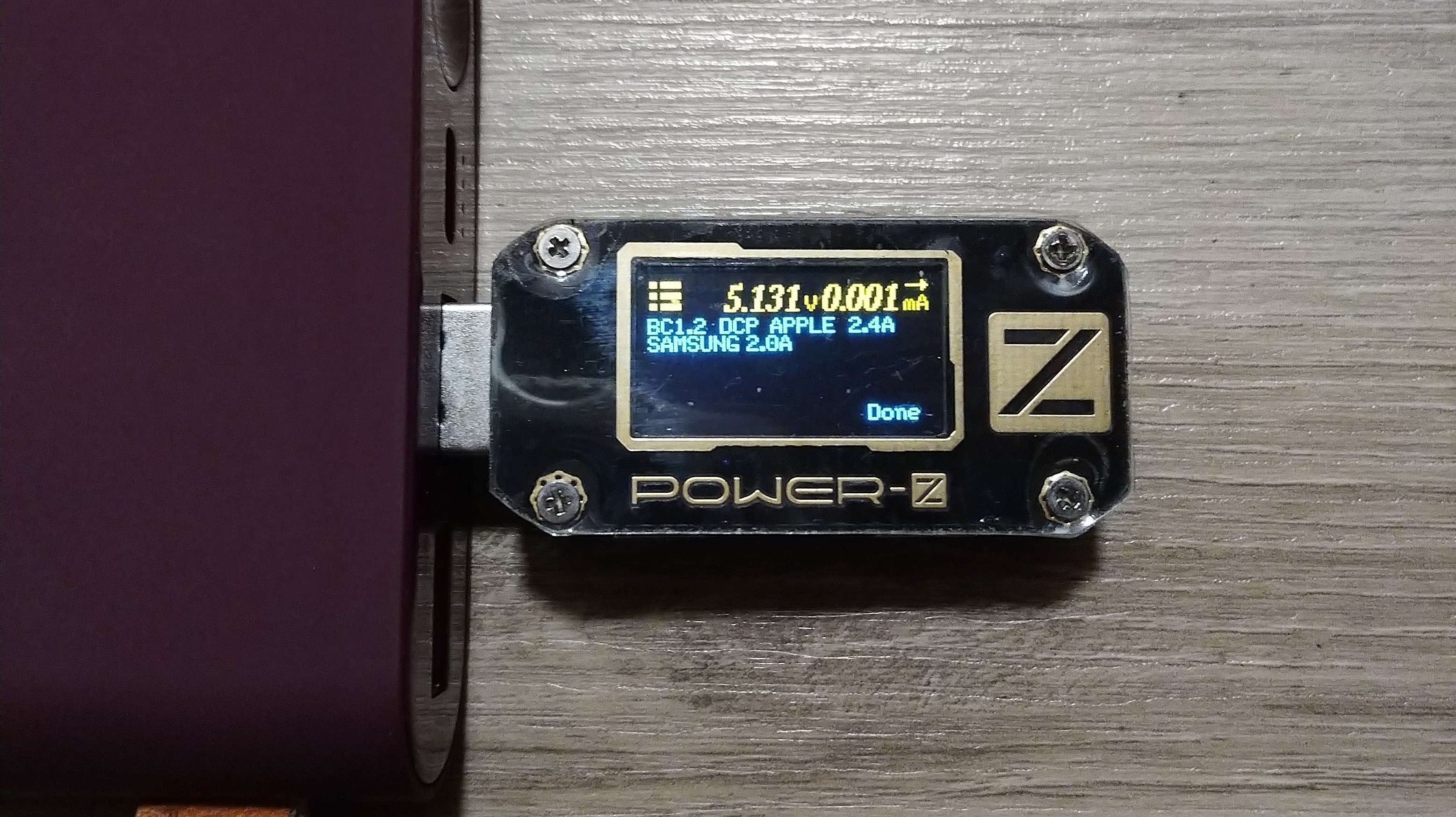

Although you are talking about PD protocol … here are my two cents. IMO (concern), it is about having APPLE 2.4A protocol negotiated (up to 5.2V range) to charge Librem 5, as sink (over USB-C output source as well), and therefore produce extensive heat (in short). It is about mostly having Apple 2.4A protocol present (if not avoided) within USB-A or within USB-C power supply controller. It is about that the same power bank with few charging outputs having ports with and without APPLE 2.4 present:

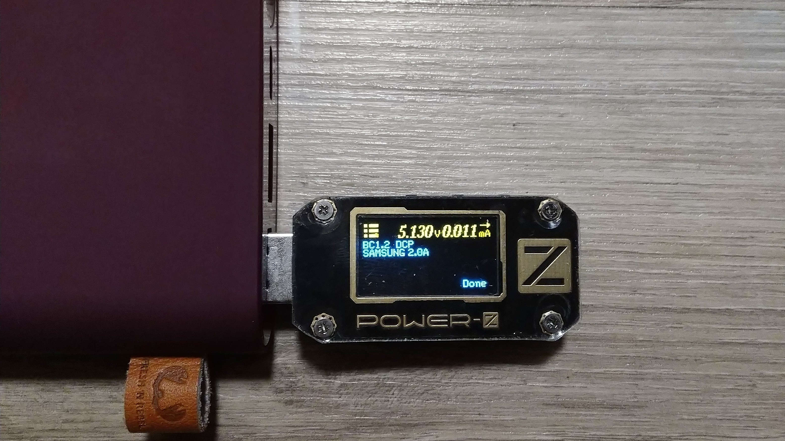

Badly selected charging port (if so):
As pictured above (perhaps needs to be further researched), but SAMSUNG 2.0A protocol is not disturbing factor (interfering protocol) as when charging Librem 5 with such power supply Librem 5 will pick up USB-DCP (5V/1.5A) protocol (might upload some evidence if needed).
P.S. Now someone might understand on why here related manufacturer lough, not so much as before, while transparent presence is gone now (to them it is that Apple 2.4A protocol being sold all over) over this particular decision (supporting/being present within so called general full protocol power devices).

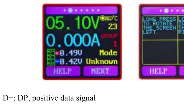

And, IMHO, all actually comes down to getting equal readings from D+ and D- (from USB tester): 0.04 and 0.04 when Librem 5 battery at 100%, coming down from 0.07/0.07 (or so, I’m tired now) when USB-DCP protocol negotiated for both D+/D- outputs in parallel. Actually I cannot explain this, not even coarse, not yet.

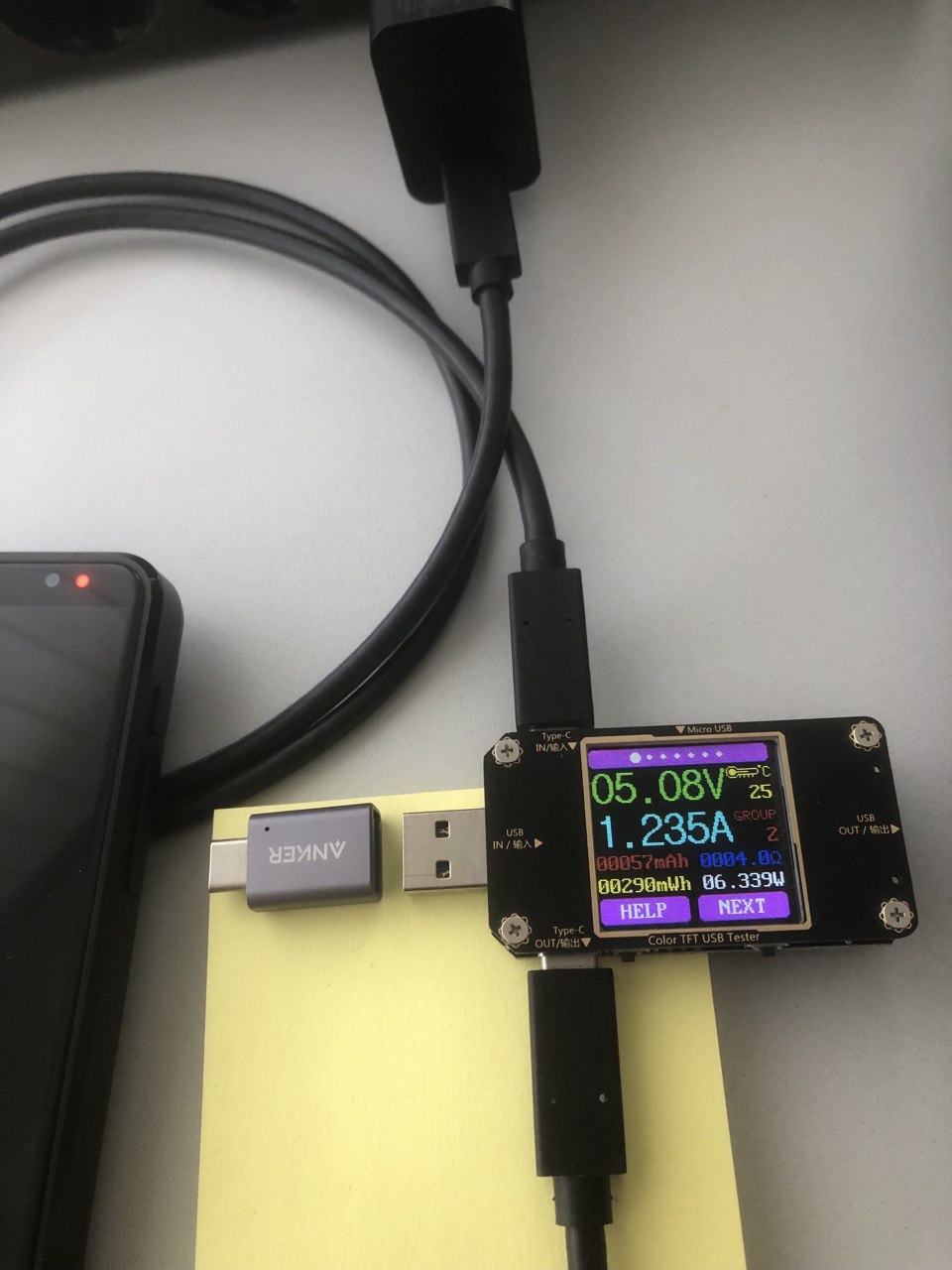

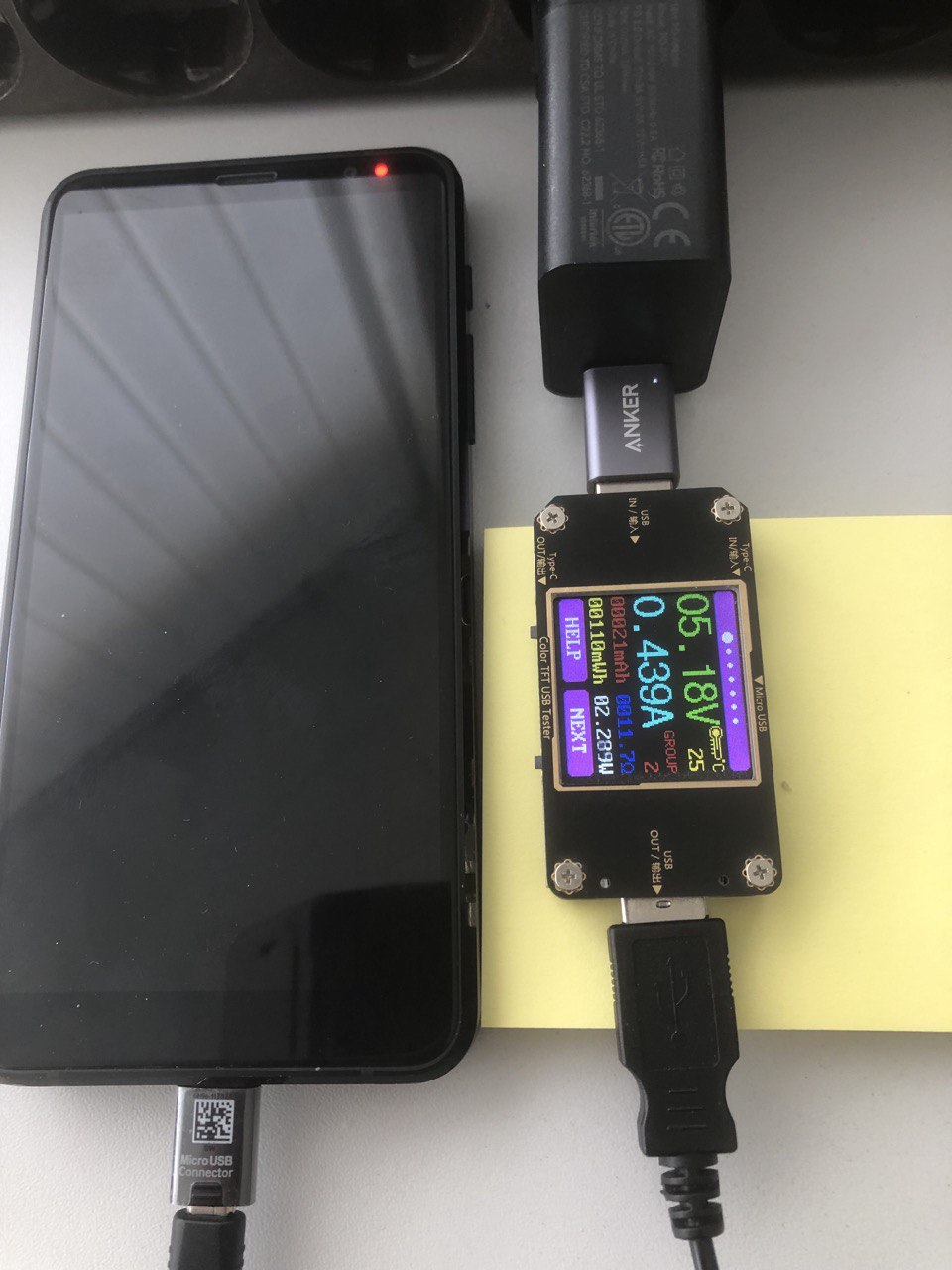

I own such a small gadget as well. When I connect it to the L5 power supply with two original USB-C cables it charges the L5 see photo (though, the gadget does not say anything about the used protocol). See first photo:
If I connect the gadget to the power supply with some USB-C / USB-A changer, it does not charge, see 2nd photo. Why it does not work that way?
I think because it has to go either across (USB-A to USB-A) or down (USB-C to USB-C).
So if you want to use the supplied charger with an adapter to USB-A, you will then also need to use a USB-A to USB-C cable to connect the USB meter to the phone.

Oh, yes. And it is working that way:

Thanks for related manual! As written there this USB tester is able to: Fast charge recognition mode: QC2.0, QC3.0 and therefore would show/differentiate only two stated protocols or show (see page 6 and note that you can read D+ and D− which would be for both channels at around or less then 0.04 for both, when USB-DCP protocol actually used, after red LED light turns off):

As second, please note that your posted picture shows that you downgraded current flow three times: once is OK (will increase charging time somewhat but protect Librem 5 from getting hot (and, let us guess, somewhat increase its battery life). Having two cable pull-up 56k resistors is already too much but should charge Librem 5 battery anyway (with having its screen off). Just avoid USB-A channel of this gadget (see below), especially if not directly connected to USB-A power supply output (those USB-A ports, power supply ports, are more then often QC protocol series related, in orange color, rather not the very special blue reserved for BC1.2 protocol, yet sometimes hiding the one to be avoided: Apple 2.4, while not having good taste with Librem 5, at least not to what I expect to get out from used power supply when Qualcomm/Apple protocols not needed). Also please do not use USB-C to USB-A adapters for charging purpose in general (like Anker OTG adapter shown), while those usually cannot transport more than 5V/1A, and might burn out easily (I guess, but certainly relies on particular adapter features).
Also, please start to move around those four multi-function buttons just by having only connection between original Librem 5 power supply and USB-C input to learn more about those switches (gadget screens options, seven independent screens, I guess).
Now, just to add to what @irvinewade correctly noticed, I’m quite sure that your USB gadget is not of bidirectional type and therefore can be used just in direction of arrows printed there and (as already written here today) actually two one way channels (USB-A input->output and the other channel) bridging each other (but not crossing).
Micro USB port there is probably not supporting charging function either (while no micro USB output there, confirming again what already kindly noted).
