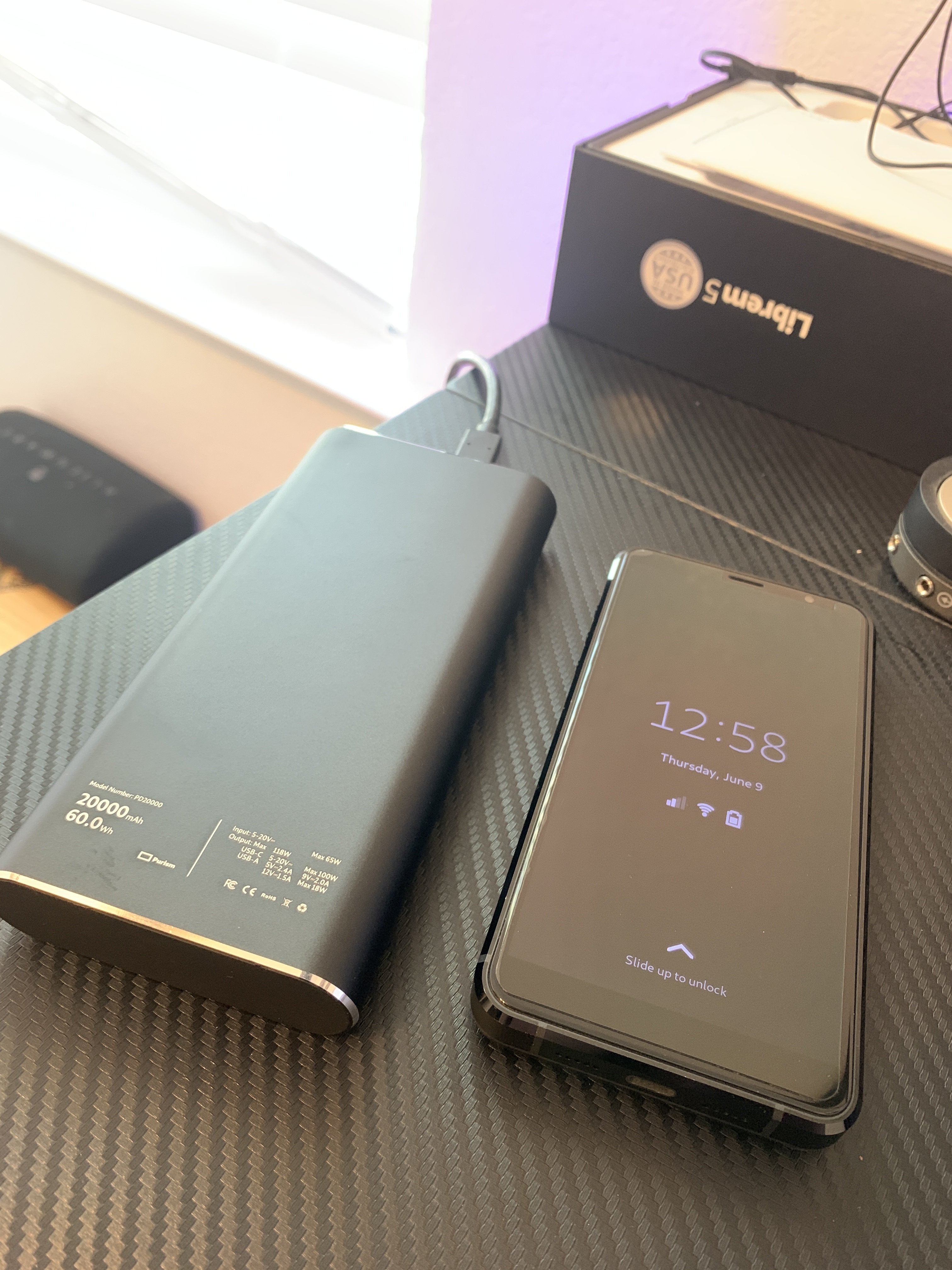

So, I decided to take one for the team and give the Purism 20,000mAh Power Bank a try. Thanks @steve for costing me another $79.00. :stuck_out_tongue_closed_eyes:
A couple of points. First, I was disappointed to see that the Power Bank did not come with its own cable. I’ve got it charging now with the L5 cable, I just would have thought that for 80 bucks it would have come with one.
Second, it’s a little bit bigger than I expected it to be. Not bad for a laptop, but I wasn’t expecting it to be bigger than the Librem 5. Photo for comparison.
I’m curious the size difference between the 10,000 mAh Power Bank and the 20,000 one for portability’s sake.

@TacticalPandaLE To be fair, I own a Samsung battery bank that is 10ah and it is roughly the same size as the L5. Granted it does also have wireless charging built in but I digress. I don’t think it’s too farfetched for a 20ah battery to be slightly bigger than the L5. Not coming with a cable is a bit unfortunate though they probably assume you already bought a relevant device and thus have a compatible cable.
