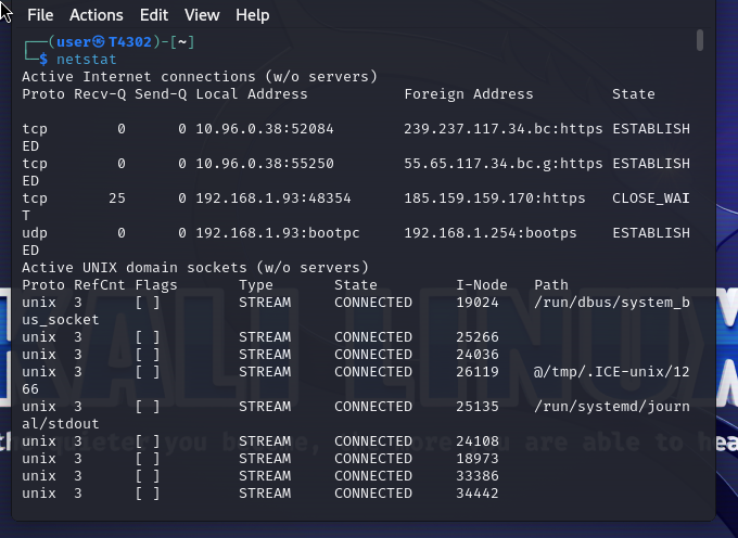

Backdoor in FireFox in Kali and Parrot OSes (and others)
Fresh downloads of each. Run netstat on both and get an ‘established’ TCP connection (outside vpn) to 55.65.117.34 which a ‘whois’ search says is related to US Air Force, USAISC (United States Army Intelligence and Security Command) (and google).
See pics.
netstat_kali_unknown_connection
Checked signatures to the extent poss. Which is not much. The parrot checksums are signed but the signature file is only available from the same website as the download.
Or am I just missing something ? - I’m a user of tech not a dev.
Something more you could check is to find out which process on your computer is responsible for the suspicious TCP connection.
There are probably many ways to do that, here is one command I have used for it:
sudo ss -tp
The output from that ss command should include a “Process” column that tells you which process is handling that specific TCP connection.
For example. when I ran it on my computer just now, it tells me there are a few TCP connections related to firefox, two connections for thunderbird and one for ssh (because of an ongoing ssh connection that I have initiated myself). In my case I think all shown TCP connections are okay, I can understand why they are there. And if I close the corresponding programs, those TCP connections are also closed.
If you run that command (or something else that gives the same info), what process does it show for the TCP connection you are insterested in?
If you do the following command it will show which process has open the connection
lsof -i tcp:<port>
You need to change <port> by the number 55250 in your first screenshot
Also 55.65.117.34.bc.googleusercontent.com has the ip 34.117.65.55 , so you are not connected to 55.65.117.34, but 34.117.65.55
Seems like firefox-esr is connected to 55.65.117.34.bc.googleusercontent.com when you launch it

Thanks @Skalman and @fralb5. Yes I noticed the IP came out in reverse in the whois lookups but I don’t know why.
If you use google maps and go to the physical address given is shows a Google data center.

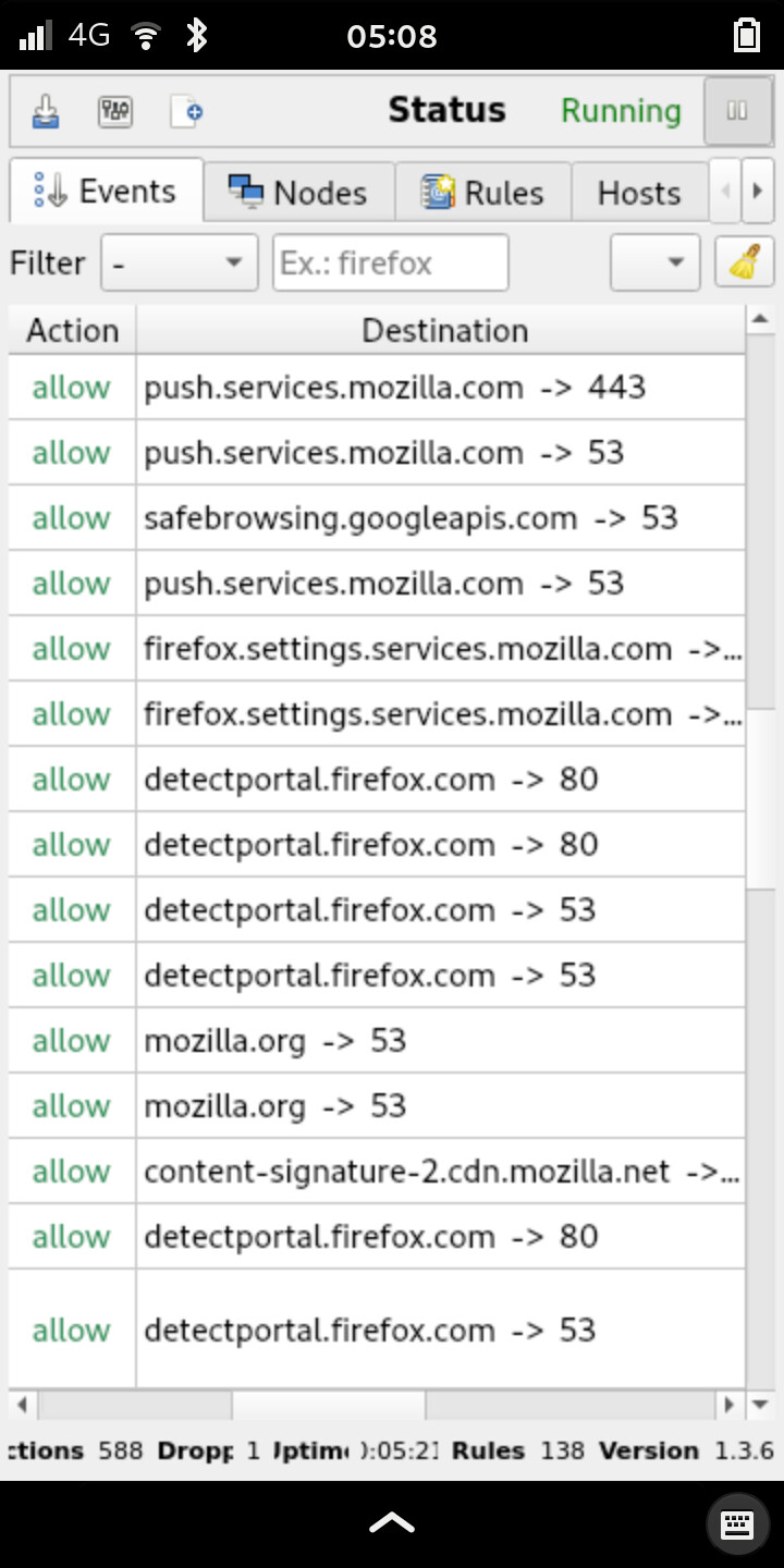

@code9n in my opinion there is no better tool than OpenSnitch to control which program is allowed to talk to which IP address.
AFAIK you should be able to install it on almost every Linux system.
I use it on all my devices to keep the programs in check, and keep certain connections i don’t want form happening.
Maybe you can also use it to keep Firefox from making that connection.
Thanks, @Manuel , I’ll look it up . . .
If you happen to have the Librem 5, there is a guide by @Kyle_Rankin for how to use OpenSnitch on it.

Read up on “reverse dns” it’s a thing that’s been around a long time.
That’s not reverse DNS that I know of, DNS is where you have a domain name and look up the IPv4 address. Reverse DNS is where you have the IP address and want the domain name.
Isn’t it? All the docs I can find say it is . . .
netstat by default is showing you the results of a reverse DNS lookup of the IP address rather than the actual IP address. netstat -n should show the IP address only.
The server in this case contains the reverse of it’s IPv4 address in it’s DNS name. A common trend today when coming up with unique indentifiers is to reverse the domain name, you’ll quite often see “com.apple.blah.blah..”, “com.google.blah.blah..” etc,. in file names, package names config settings etc,. What you are seeing is the reverse DNS of the IP which is a machine name that contains the IP in reverse notation, which is probably some scheme being used to make listing, sorting and identifing machines a little easier on their end.
