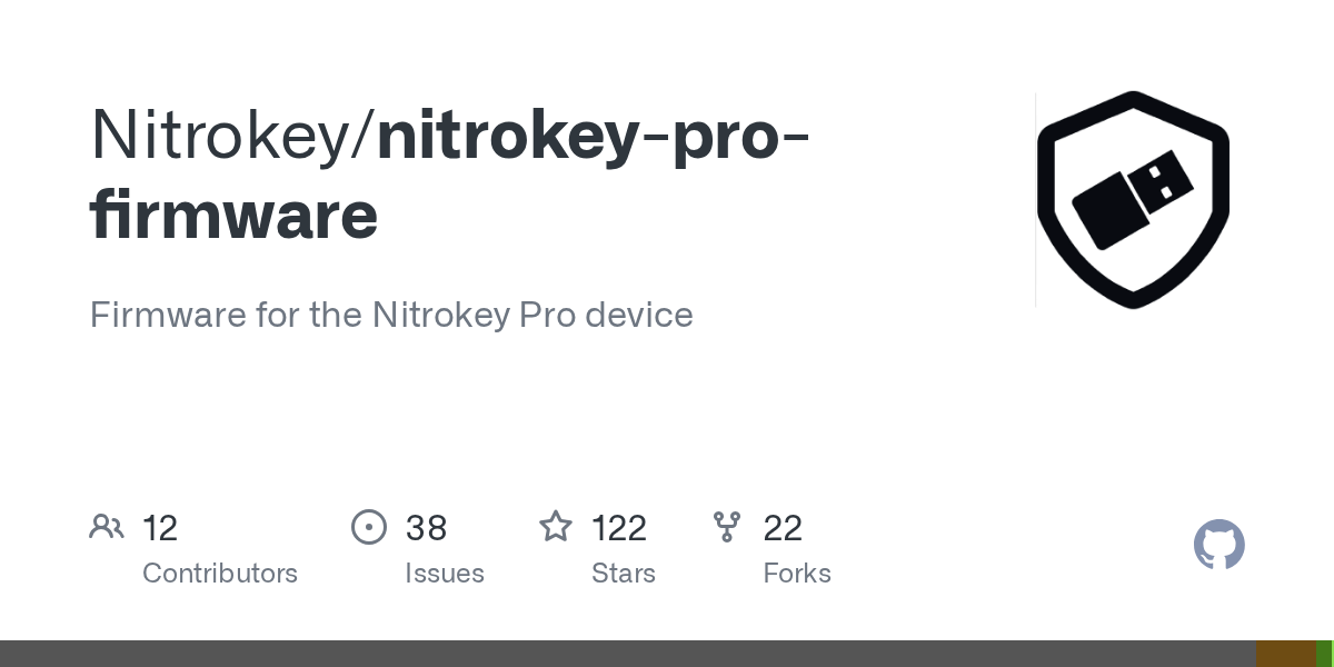

Where is the Librem Key firmware source code, and how do I flash it?

Flashing it requires taking the case apart though to short a jumper and since the cases are sealed you might end up damaging the case in the process, just FYI.
